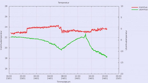

Exempel från tråden Temperaturvisning på hemsida (Raspberry-Pi):
#!/usr/bin/gnuplot reset set terminal png size 1250,700 set object 1 rectangle from screen 0,0 to screen 1,1 fillcolor rgb"#E6E6FA" behind
set output '/var/www/bild.png' set multiplot
set xdata time set timefmt "%Y-%m-%d %H:%M:%S" set format x "%H:%M\n%d/%m" set xlabel "Timme/datum"
set ylabel "Inomhustemperatur" set yrange [15:28]
set y2label "Utomhustemperatur" set y2range [-20:10] set y2tics nomirror set y2tics
set title "Temperatur" set key reverse Left outside set grid
set style data lines
plot "logg.txt" using 1:3 axes x1y1 lw 3 title "inomhus", "" using 1:4 axes x1y2 lw 3 title "utomhus"#
Exempel på graf
